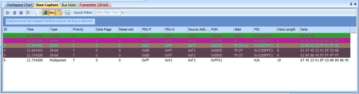

Boyce, thankyou very much. please find below screen grabs and copy of the code that is sending a 28 byte multipacket J1939 message made up from variables pulled from powervision. I would have never worked out the nibble bits. Perhaps some examples of these along with words and bits could make their way to the next user guide?
For refernce I gave the first 6 values AA BB CC DD EE FF so I could see the placment in the transmitted response, and the rest are some ransom value. The last 2 'reserved' were packed with AB, CD, again so I could check where they appeared.
then with fildter applied in CAN capture you get this segmented data...
or with no filter, the full multiplex string....
I'm off for a beer after that small triumph. thanks again :)

CANMessageInfo info;
info.MessageType = CANMessageInfoType.MultiPacket;
info.DestinationAddress = 0xFF;
info.RtsCtsMaxPackets = 3;
//setup the header and the message structure
CANMessageBuffer buffer;
buffer.CanID = 0x1FF08; //TX ID
buffer.Size = 28; //Number of bytes to send
// Write 8 bits, (byte number, contents);
buffer.WriteInt8(0, byte0);
buffer.WriteInt8(1, byte1);
buffer.WriteInt8(2, byte2);
buffer.WriteInt8(3, byte3);
buffer.WriteInt8(4, byte4);
buffer.WriteInt8(5, byte5);
buffer.WriteInt8(6, byte6);
buffer.WriteInt8(7, byte7);
buffer.WriteInt8(8, byte8);
buffer.WriteInt8(9, byte9);
buffer.WriteInt8(10, byte10);
buffer.WriteInt8(11, byte11);
buffer.WriteInt8(12, byte12);
buffer.WriteInt8(13, byte13);
buffer.WriteInt8(14, byte14);
buffer.WriteInt8(15, byte15);
buffer.WriteInt8(16, byte16);
buffer.WriteInt8(17, byte17);
buffer.WriteInt8(18, byte18);
buffer.WriteInt8(19, byte19);
buffer.WriteInt8(20, byte20);
buffer.WriteInt8(21, byte21);
buffer.WriteInt8(22, byte22);
buffer.WriteInt8(23, byte23);
buffer.WriteInt8(24, byte24);
buffer.WriteInt8(25, byte25);
buffer.WriteInt8(26, byte26);
buffer.WriteInt8(27, byte27);
//Send the whole lot out
int port = 0;
SendCANMessage(port, buffer, info);
