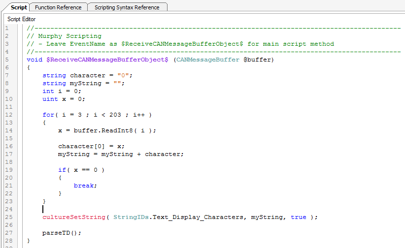

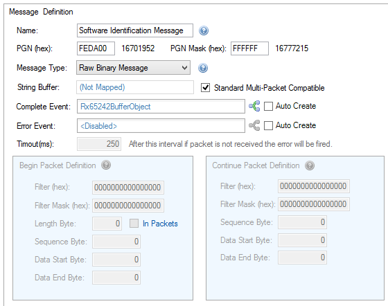

I am attaching some screen captures as examples of how one of our leading custom configuration developer handles messages containing string data.
The PGN is the PDU Format, PDU Specific and Source Address bytes of the identifier.
If you have the Standard Multi-Packet Compatible checked and the data is eight bytes or less, the message will not be handled as a multi-packet. By checking it, you can easily use a script similar to the example to parse the data from the message buffer to a string data variable.
