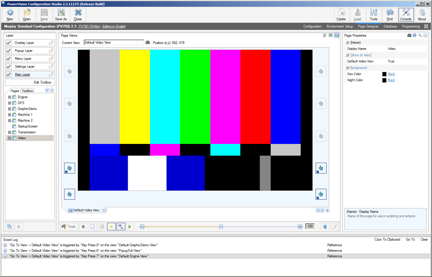

The simplest way is to remove references to the video view.
In the 2.3 Murphy Standard configuration there are 3 key presses with a GoTo View to the video view.
Key Press 7 on the view Default Engine View
Key Press 8 on the view Default GraphicDemo View
Key Press 6 on the view PopupFull View
If you remove the Go To View action from those key presses the video view will not be shown in the configuration without the need to eliminate it.
Regards,
ksaenz
- Video view references.png (107.81 KiB) Viewed 176 times
