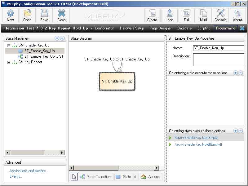

You will need to create a 'State Machine' in the 'Programming' tab in the Configuration Tool so you can enable the desired feature with either:
A simple way to demonstrate this is to create a new one state State Machine in the Programming tab. Name it something like 'SM_Enable_Key_Up'.
Add a single State to the State Machine. Name it something like 'ST_Enable_Key_Up'.
In the 'On exiting state execute these actions' section click on the '+' key. In the dialog that pops up, click on the 'Keys' application, then click on the desired Action - either 'Enable Key Up' or 'Enable Key Hold'. Then click the 'OK' button to finish adding the exit action. If you want to enable both features at the same time, go ahead and add a second exit action to do this.
Then add a single 'State Transition' to the State you just created. Click on 'State Transition', then click and hold on the State you just created. Drag the mouse pointer around outside the State box then back into the State box and release the mouse button. You should now have a 'loop around' transition named something like: 'ST_Enable_Key_Up to ST_Enable_Key_Up'. Leave the 'Generate Event for this transition' box checked.
The attached image file shows a picture of what this would look like: Now to enable the feature, you need to 'trigger' the event that you just created:
A simple way to demonstrate that is to go back to the 'Page Designer' screen and assign one of the 'Key Press' selections to fire the event you just created. (Note: 'Key Press' unlike 'Key Hold' and 'Key Up' is always enabled.) As an example, if you click on the upper left key and select 'Fire an Event', you will find the event you created in the list. Select it and click on 'OK'. Now all you have to do to active the desired feature is press that button.

Enabling 'Key Up' and 'Key Hold'
Code: Select all
Keys->Enable Key Up((Empty))
or
Keys->Enable Key Hold((Empty))
